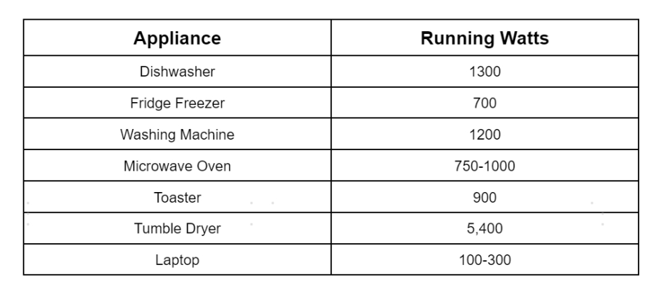

Another term you should acquaint yourself with is Power Rating, which is an important number to watch out for. It indicates the maximum amount of power the battery can deliver at any particular time, again measured in kW. The reason this is important as it will determine how many appliances and home systems you’ll be able to run at the same time.
Conversely, battery capacity will determine how much time those appliances can run, so they’re effectively two sides of the same coin. When working out this figure, try and consider what will be used at peak times of the day. In the table below, you can get a good idea of how each appliance is rated in terms of running watts.
EcoFlow Image
Essentially, you need to ensure that the power rating of the home battery you choose exceeds your maximum need at peak times, or you'll have to start choosing which appliances not to run.
